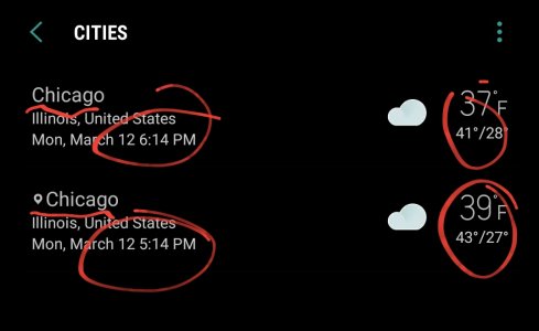

The solution that works permanently for me (CST, Chicago) is to delete DATA and then manually add the city. When the app automatically adds the city is where the glitch seems to happen as you can see here...
I tried that before I emailed the web site and when I manually added in the city, the time went back to an hour behind.
