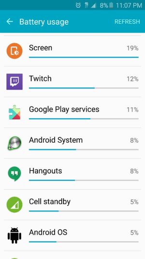

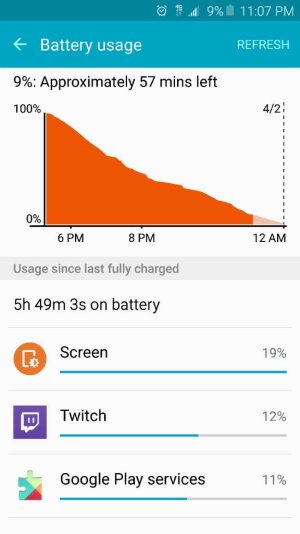

Today I watch a stream for an hour and a half at high brightness.... About ~2 GB of usage.... Then back to normal brightness and sporadic usage every few mins.

Hero,
It's a bug in T-Mobile. Most see this after turning off wifi calling.
Woohoo! May I ask what brightness settings you have and if you use location services or have exchange services pushing in the background?
This is not my phone, but someone on xda forums. So I can't really say much more on this. I'm waiting for tomorrow and will check on any new updates.
Some say it doesn't work for them (turning off wifi calling), but most are experiencing a difference like the above screen shots.
Would appreciate it if more people can confirm turning off wifi calling does increase the battery juice.
Thanks!
