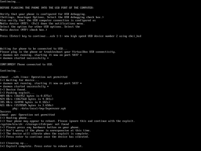

I rooted my bionic it worked great when to root my friends for him and I get /system/bin/sh: not found and it does not continue. Any help on that would be great.
so here is my linux minimal screenshot attempt. . noticed where it starting going wrong is
chmod: pwn: operation not permitted.
rooting phone...
phone may appear to.......
/system/bin/sh: /storage/rfs0/pwn: not found <-------Right here i noticed the file path on the phone and it's ---> storage/rfs1 Would that have something to do w/ it?
nothing ever vibrates and reboots in flash. got bad flash or something?

Link to new version of file added to original post. I added some lines to the script to stress the importance of pressing one of the three hardware buttons on the phone (Volume up, Volume Down, or Power) once the exploit has been executed. After discussing this with the author of the exploit, this is an important step to obtaining root.
Looks like you're using an old version of the download. I wrote logic into the script of the last 2 versions that will find the file and use the proper path.
rooting phone...
ok just to confirm. after is says don't skip this step. press any of the hardware buttons. then says when fully reboot press enter.....
so i just press one of the three buttons just once, no reponse or vibrate when pushed (except volume up or dow whichever is pushed) and then sit patiently for it to reboot on it;s own? cause it seems like it was not doing anything but i could have jumped the gun and not waited long enough? or when press hardware button is it a hold, or if press power and shuts down screen is that ok? oh yeah and wondering if you could post link of most uptodate version i should be using? this was what i used last attempt after you stated u had more up to dates. is this the right one? Root_Bionic_JB_20130501-1
