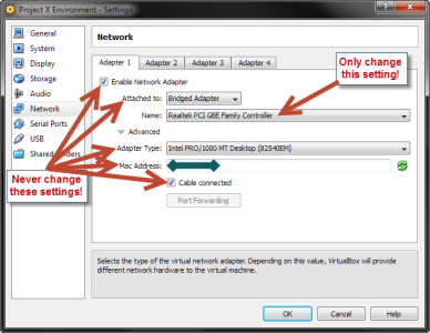

Here are some tips for anyone who is having trouble getting a valid IP address. The first thing you should check is the network configuration within VirtualBox. If your computer has more than one network adapter, VirtualBox may be trying to use the wrong one, which would result in the Linux VM being unable to acquire an IP address. Please look at the attached picture. The only thing you should ever change is the drop down box field called "Name:". If you change any other settings, either change them back, or re-import the .ova file again.
