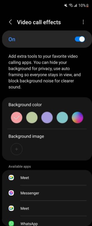

Problem finally solved. Turn off the Samsung video call effects and reboot. The WIFI echo calling problem will be gone never to return!!
So i see this issue hadn't been fixed yet. I've been waiting a year. Been on with Verizon a bunch last October and even got a replacement GS21+ instead of my 21. I just noticed the wifi calling was turned off so i turned it back on and now mom said i can hear myself again. It ruined the conversation and she got off the phone. Back in the fall Verizon tech support said it's a known issue and the next update should fix it. So now it's almost the fall again and still not fixed.
THIS is the solution: Problem finally solved. Turn off the Samsung video call effects and reboot. The WIFI echo calling problem will be gone never to return!!

Are your Samsung video call effects on or off? It they are on turn them off and reboot and keep them off. The echo on your caller's end will go away.
I googled it and isn't that just the backgrounds on the call screen or color of it? If so how does that cause the echo?
