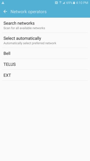

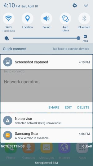

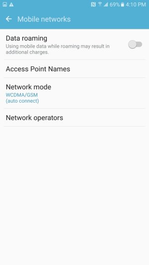

Screenshot_20160410-161028.jpgScreenshot_20160410-161018.jpgScreenshot_20160410-161043.jpg
When I click on Bell it says unable to connect.. also says unregistered sim now. before it said emergency calls only.
