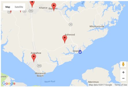

There's one tower servicing our area, with 3 'cones / beacons / whatever they're called' pointed in different directions to broadcast the signal. They are supposed to reach up to 5 miles. My boat is on the far side of that range, as noted in the attachment with the blue circle. Found this website, didn't know it existed: Oriental, NC Cell Towers, Signal Map & Lease Rates | CellReception
US Cellular isn't even shown as one of their "top 4", not surprising. From reading some of the reviews, thinking I shouldn't feel too bad about my service :(

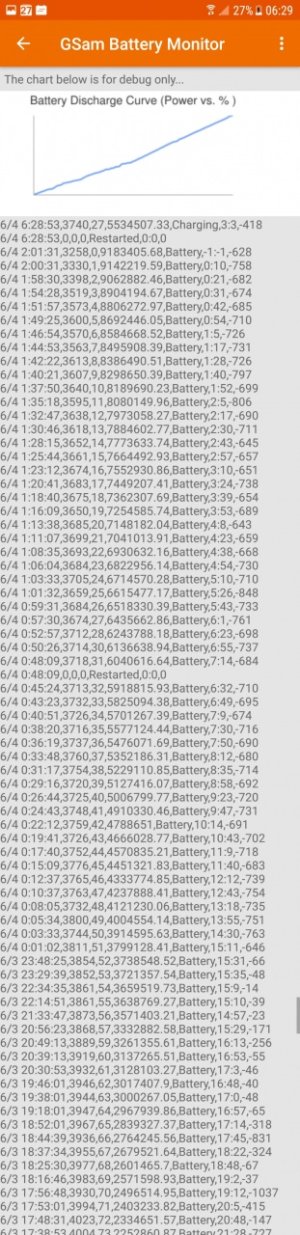

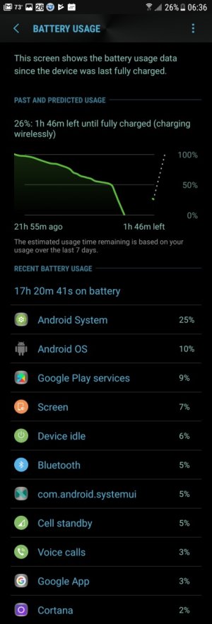

Woke up this morning to a dead phone ... and it had been working so well! Got the debug chart from GSam, hoping that it means something to you either @LineKill or @SpookDroid. Also attaching the chart from the built in battery monitor since it shows the nosedive. No temperature information unless it's hidden in the GSam information. I know US Cellular is still working on the signal strength issue. Do you see anything else in here that tells us anything?
