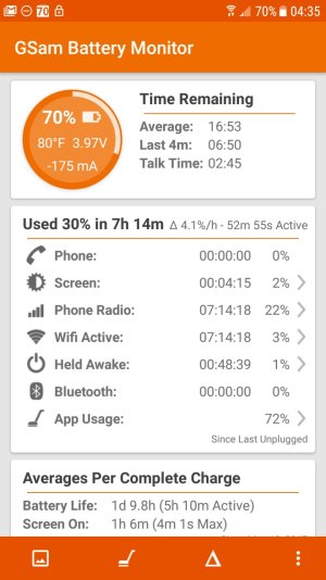

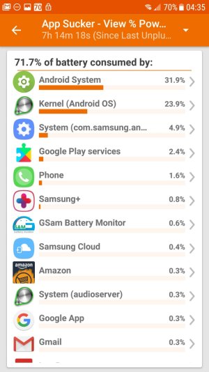

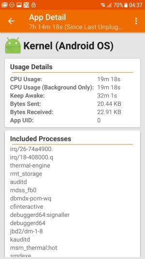

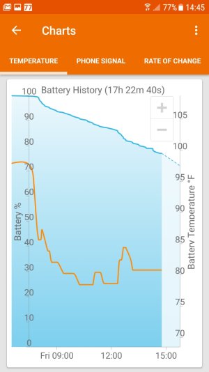

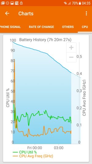

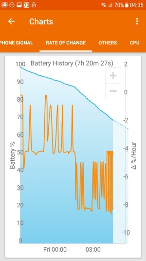

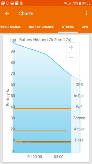

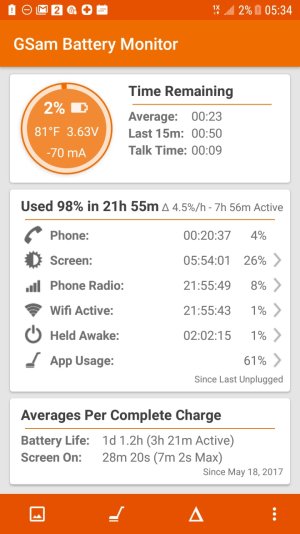

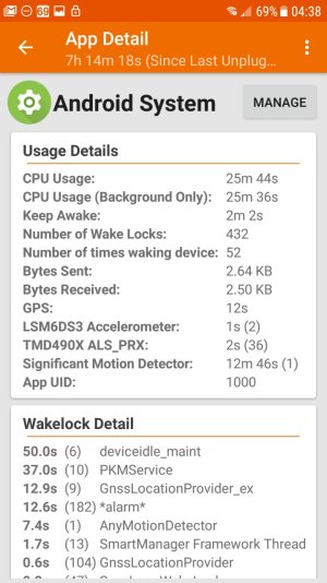

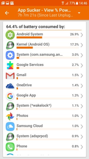

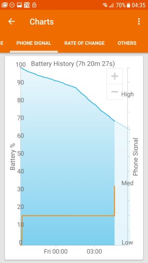

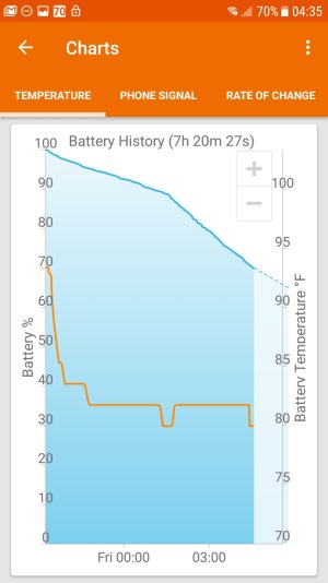

Did the FDR last night, removed and have left the SD card out. Only installed LastPass and GSam, plus my accounts for Google, Samsung and Microsoft. Phone was at 100% before taking it off the charger and calling it a night. 70% this morning. Attaching screenshots for review. Doesn't look like I'm getting the high temperature like I had been seeing, but will keep an eye on it (and a feel) and see if I can get any more information during the day today.

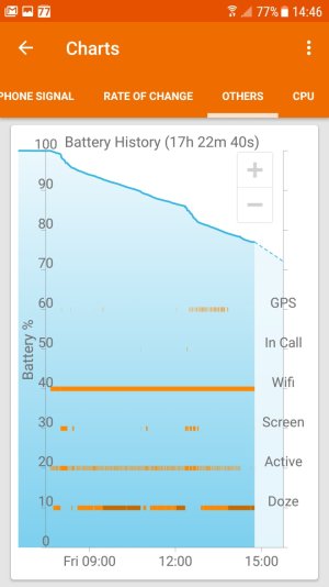

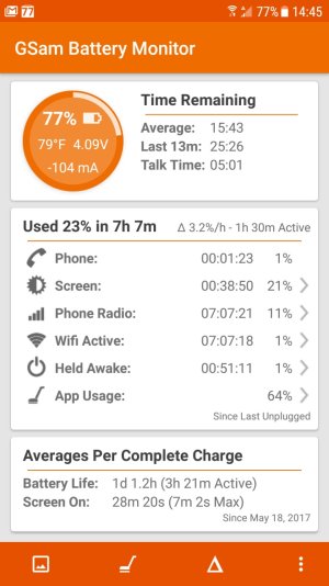

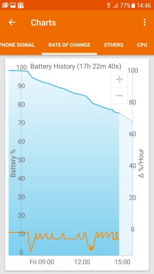

I know you don't have a lot of control there, but damn that's bad reception! Also, see that exclamation mark on your WiFi icon? That means the network does have connectivity issues, so the phone is struggling to get data in/out, which is a very big battery drain (it's like having a 2-hour conversation whispering VS shouting... the latter will have your pipes sore by the end of it).

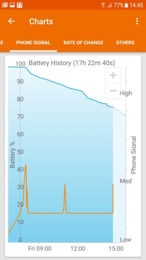

@SpookDroid and @LineKill, yes, we're kinda at the end of the road to nowhere (but it's a beautiful spot on the water) pretty far from cell towers. So reception isn't the greatest, or WiFi, even though sometimes I do see 4G. But at my shop, I'm closer to the cell tower (but in a metal building) and we have Time Warner digital WiFi so things should be better. Attaching screen shots from today at work, and they don't look all that different. Let me know what you think, and if I'm fooling myself that the phone should last longer. What gets me is that for 4 months I was having GREAT battery life, then in one week had 2 nights in a row of phone dead in the morning and it's gone downhill since. And updating from M to N hasn't seemed to change anything.

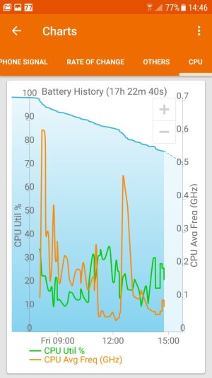

@LineKill, the latest screenshots were from work, and I have had instances where the old phone would go from 100% at 7:30AM and would be down to 40% by 11AM at work, and it would be really hot. Haven't had this phone long enough to know any of that. The old phone would also get hot and drain when it was in my fanny pack, when it should've been off because of Smart Screen or whatever it is that is supposed to keep the phone off if it thinks it's in a bag. I have intentionally NOT put the phone on the FastCharge puck overnight, but if that's not an issue for the phone then I can put it on the charger each night 'just in case'. What do you think? Would that kill my battery life from overcharging?

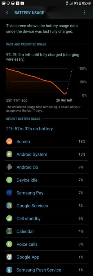

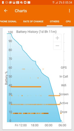

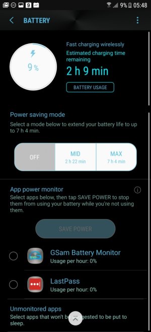

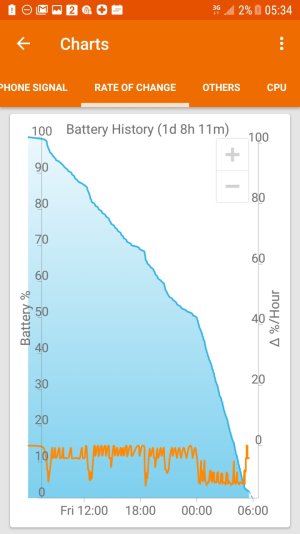

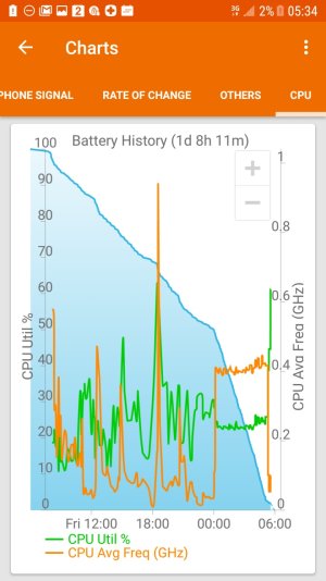

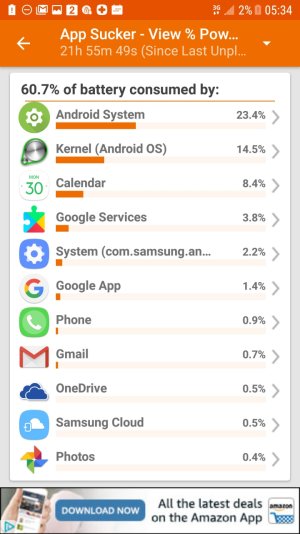

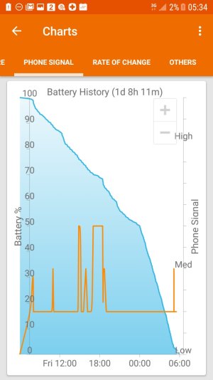

So, I decided to try an experiment and see how my phone would behave if I turned WiFi off before going to bed. Phone was left screen-side down. Failure! Woke up to 2% battery. Screenshots attached.
Just discovered that "keep screen turned off" was turned off, so having phone screen-side down wouldn't have helped.

If you are concerned about your battery degrading from leaving it on the charger overnight turn off fast charging, you really don't need it overnight.
What I really don't understand is why the phone had no issues staying off the charger overnight for the first 4 months I owned it. Then all of a sudden it started having issues. Makes me wonder if US Cellular may have a tower issue? Not sure how to check that out.
Personally, I think it would be more so your cell reception rather than WiFi. Maybe your carrier had some changes with their network right before all this started happening.
I'm going to call my guy at the USCC store tomorrow when he's back from vacation, and see if there's any way for them to check that out. Started mid-April. I've also asked others in the town (via FB page) whether they've noticed any recent issues. Would be good to have more data. I know I missed 2 calls last night, and phone was 'searching for service'.
Update: called US Cellular and talked to their Tech Support and Roaming people (phone ended up roaming yesterday). Advised them that there were issues down here with signal strength since mid-April, and they said they'd escalate the issue to engineering since it's gone on for some time (nobody had reported it ... so I'd advise others to be sure to speak up to your carrier). Hopefully they'll find something that they can fix to improve our service. In the meantime, making sure that my phone has what I think is enough charge to get through the night. So far so good, if 3 nights can tell you anything.
