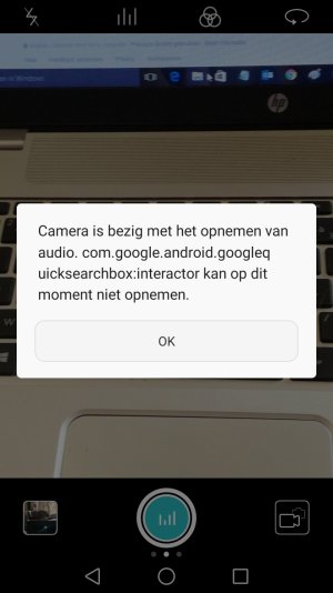

I have owned a Huawei P9 Lite for roughly 6 months now and am quite happy with it. However, for the past few days, I've been having the following problem ...
Whenever I open the camera, I get an error, which, roughly translated from Dutch, says "Camera is recording audio. Com.google.android.googlequicksearchbox:interactor can't open at the moment"
(I added a screenshot)
If I tap "OK", the error message disappears, but pops right up again seconds later. I can use the camera, but it is of course very annoying if you can't see what you're snapping pictures of.
I've been Googling about this and I found out that Quicksearchbox refers to a search box or Google Now. However, I do not have a search box widget on my screen and I also don't see the connection between the camera and that, nor the link with Google Now.
I can't find any topics about the entire error on Google.
Does anyone have any idea what's going on? I would prefer not to do a factory reset if not necessary.
Greetings,
Lenny
