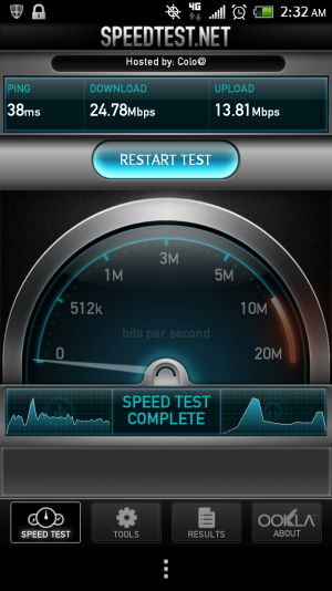

I posted something a while ago that was trying to help people with their connection issues because it's a hot topic of conversation. I figured I'd post my entire phone's settings and maybe that would assist some people further. Maybe the "fix" I was referring to had nothing to do with it, maybe it did. It seemed to work for me, but either way I seem to have an amazing connection 99% of the time. I've only found one spot without service, and it's literally in a hole/valley where I wouldn't expect there to be service. If it was something else you can get some insight here. Then I'll move into getting better battery life WITHOUT losing the ability to have all the fun stuff on your phone (turning off HD Youtube and Facebook wouldn't be fun, right??) I love this phone - everything about it.

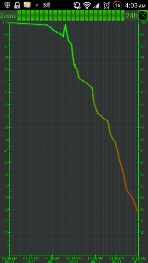

GET BETTER BATTERY LIFE

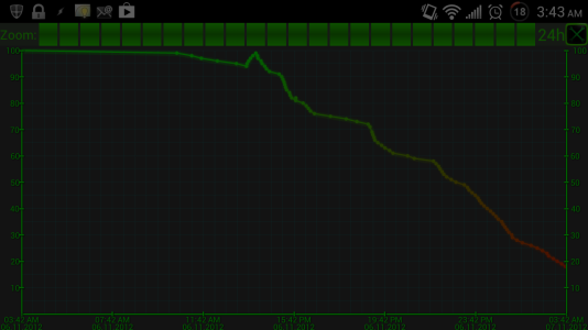

We all want bigger, better, faster without loss in performance. Guess what - The EVO can do everything you need it to do and you don't need 1500MHz to do it. Here's my entire setup. Right now I've been going exactly 24 hours and have 20% battery life remaining - and I'm a HEAVY user. So much so that my Queen yells at me sometimes! There is a little gain of 5% on the graph you can see where I was putting music on my phone, so naturally it charged for a bit, about 5%, so we'll say 22.5 hours ;)
Constant texting. I mean constant. I have a serious addiction that I should probably consider addressing. A few hours of browsing using Dolphin. Watching 4 HD YouTube videos (about 4 mins long each). Sending about 20-25 emails. More browsing the internet. Screen on for 30 minutes to put music on the SD. Taking about 15 pictures and then editing them and sending them to Instagram. Looking at Instagram pictures for about 45mins-1 hr. Screen on for an hour while typing all this. Daughter playing a game for about 45 minutes in the car. GPS scanning every two minutes, 24 hours a day regardless of if a location based profile is active in Tasker (I should probably fix that, huh? haha). WiFi or Data always on unless Juice Defender says otherwise...etc ..etc. In an 8 hr period, I'm seeing that I was using it 5 out of the 8 hours. I'm going to ballpark (because I accidentally reset my log) that I'm using the phone 75% of its uptime. No. I really don't sleep. (Okay, maybe about four hours a day. I'm a busy guy!)
I always have the following apps either running or scanning something: Juice Defender, Brightness Manager, Tasker, Smart App Protector, Juice Plotter OR Battery Info, NOVA Launcher, 3G Reconnect...I think that's all...
