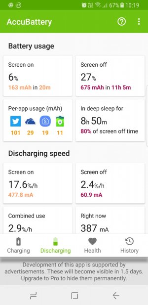

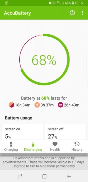

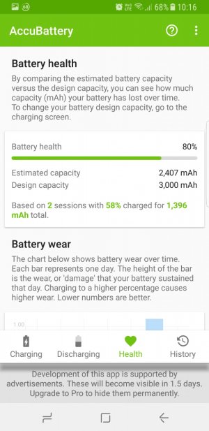

So I've installed an app called AccuBattery and it has been gathering statistics.
It shows this:
So, from fully charged last night, down to 68% as at 10:24 AM.
The estimates of how long the battery will last don't seem realistic.
The battery health was initially reported as 86%, it's still gathering data, but that number is falling.
The "mystery icon" using battery is Samsung TouchWiz which I understand is an integral part of the phone/OS and presumably normal - I have never analysed the usage before since I had no need.
OneDrive was opened precisely once: to sync the screen shots to my PC in order to post this.
The "Deep Sleep" data is believable - about 7.5 hours asleep last night (me, not the phone).
In the absence of any other explanation I'm assuming that the battery is beginning to fail and that the rate of failure is not gradual but rather rapid.
Can anyone see anything else of significance?
