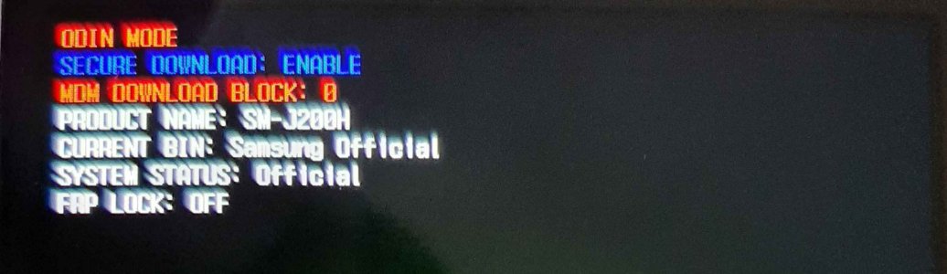

Can you get in recovery and take screen shot there ?
Ok.
I get in recovery mode ...in top of the screen I can see this
Code:
LMY48B.J200HXXU0APK1
Also, I have reset the factory option
wipe data/factory reset.
Do you think that if I factory reset the phone from here one more time...Maybe the problem will be solved!
and my firmware not listed on the previous sammobile link and I search google and found out this link https://galaxyfirmware.com/model/SM-J200H/MID/J200HXXU0APK1
what about this?
Code:
what about this?
Try one more time to factory reset see if u can get it going , and yes perfect that's your build number , I'm not familiar with that site but if 2nd factory reset doesn't work then try it
I'm not sure which Odin will work on the older phones but try the latest 3.14.1 if not then go down to say 3.09 xxxx version

But with the installation of the new firmware, everything was fixed.
Thanks for the help, especially the PDA number.
