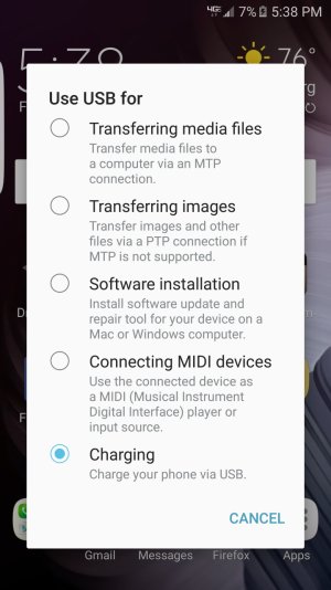

Yea I have 2-3 fast chargers that all seem to work fine on my wifes s6. That screenshot was taken while plugged into the original white charger into a wall outlet. I understand these options will popup when plugged into a computer. Thats why its so weird. Its plugged into the wall charger. But it seems to think its hooked up via USB into my computer. Maybe my charging port went bad

So here's the solution I came up with. Please forgive the errors as I have to translate it from Dutch so it might be called differently here and there ;
- Go to settings
- Go to phone info
- Go to software info
- Tap several times on build number until it says you're a developer
- go back two steps, scroll to the bottom and select developer options
- find the option 'usb configuration'
This will be most likely set on mtp
- set the option to 'charge'
It will be active as soon as you select it
Now try charging. I just charged from 86 to 100% within 15 minutes which was 1,5 hour before changing this option
It does not say fast charging with the powerbank but judging from the speeds I get it actually does.
My car charger does say fast charging now.
It's not as fast as my LG but I can live with that.
Hope this works for you as well. Let me know.
Obviously, if you do need mtp for syncing your phone with your laptop you need to change the option back. That's no issue for me as I do everything wirelessly.
By the way, charging via a USB port on my laptop is also significantly faster now, a USB port can deliver 1A if no data is used and apparently this is the case now.
