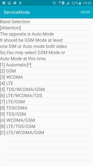

4. Select Stack 1.
6. Select Band selection.

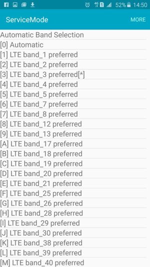

8. Select Automatic.
10. In my case, I select my preferred band 3.

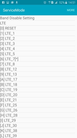

12. Select Band Disable.
14. Select LTE.
16. In my case, I select my LTE band 7 to be disable.

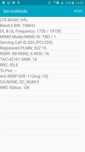

19. Type *#0011#
21. Select Stack 1.
