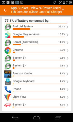

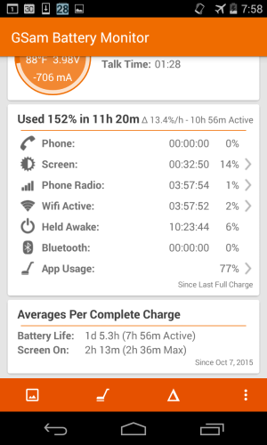

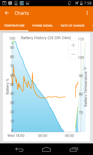

I usually put my phone in airplane mode while I sleep, and my phone's battery doesn't drop too much. However today it went from about 55% to turning off itself. Can you tell what might be happening based on the GSam Battery info below or do you know what I could check? I don't have Wakelock Detector installed right now, but I will try to do that to get more information.
I also feel like recently my phone screen will be on sometimes even when I go look at my phone though my settings have it turn off after 2 minutes of inactivity. I feel like it might be related to my Call Blocker by Android Rocker and that even after 2 minutes after a call being blocked the screen is still on, but I cannot prove that. However, I would not be receiving any calls in airplane mode, so that wouldn't be waking up my phone.

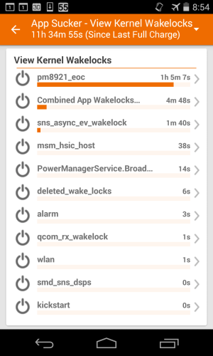

I figured out that GSam does have wake lock information. But after briefly searching for pm8921_eoc I just saw that it had to do with charging, so I'm not sure that's what drained my battery. Do you have any idea what might be happening?
