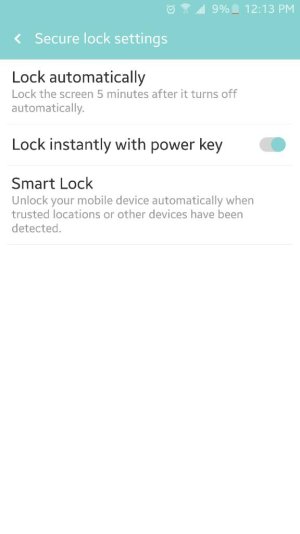

Re: Finger print security selected, but sometimes phone only asks for a swipe to unlock
Under lock screen and security, there is also the option to make it secure lock when you press the power button. If that is turned off and your time out is 10 minutes then it won't secure lock when pressing the power button.
