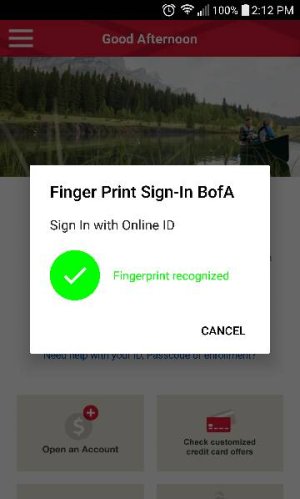

Back in business! Out of nowhere the fingerprint reader starts working again! Super happy to have it back. 😃😃
This is the 3rd cycle it stopped and started working again. It's usually out for a week or two.
The last time it didn't work was before I dropped it in water. A few days later it worked.
Very strange.
Also it definitely gets hot 🔥 right underneath where the 808/SOC has been mentioned to be. With around 300 apps I can burn through a full charge....sometimes as quick as about 1.5 hrs.
