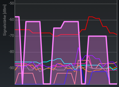

Hello,
I am not sure if my problem is the same as others have with 5GHz wifi. I have three Nexus 4 devices here. Two of them can see the 5GHz network fine and can connect to this. I do not know if the speed is ok though. But my problem: The third Nexus 4 can only see the 5GHz wifi sometimes. After one or some more seconds it disappears and then shows up again. This even happens right beside the wifi router (in 1m distance of it). The phone is not able to connect to the 5GHz wifi. Or it looses the connection after 2 seconds again.
I try to upload a screenshot of the wifi analyzer app:
The pink curve is my 5GHz wifi signal. The red one is my 2.4GHz signal. The same scan on the the other two Nexus 4 phones does not show these gaps, instead the curve is continuesly on one level.
I already tried to switch from channel 36 to 44. But this did not change anything.
EDIT: The router is an Asus RT-AC66U.
What might be the problem here? Is this an hardware issue? Is it one of the known wifi driver problems in android 4.3? (But all phones do have the same android 4.3 OTA firmware. None is rooted or modified. Only one of the working phones has an unlocked bootloader as it had to be cleanly reflashed after a boot loop problem that came with the 4.3 OTA update).
