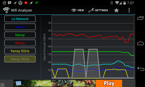

Sorry for the thread highjack but I think I might be experiencing the same problems as the previous poster. My almost 1 year old Nexus 4 started having problems connecting to my 5Ghz wifi setup. In fact it won't connect to it at all anymore. Using wifi analyser I'm getting similar drops as the previous picture:
FTR, I have two Cisco E4200s running as just APs. The 2.4 is frenzy and the 5ghz is frenzy 5Ghz.
I'm getting the same kind of see-saw behaviour. Now I'm thinking it's related to the Nexus 4 only because the wife's iPhone5S, our iPad and my work laptop can all connect to the 5Ghz SSID with no issues and drops. This only started recently as I've had the routers for a while now and have always used the 5Ghz frequency with my Nexus 4. Is this cause for an RMA at this point?

I am not sure if my problem is the same as others have with 5GHz wifi. I have three Nexus 4 devices here. Two of them can see the 5GHz network fine and can connect to this. I do not know if the speed is ok though. But my problem: The third Nexus 4 can only see the 5GHz wifi sometimes. After one or some more seconds it disappears and then shows up again. This even happens right beside the wifi router (in 1m distance of it). The phone is not able to connect to the 5GHz wifi. Or it looses the connection after 2 seconds again.
I try to upload a screenshot of the wifi analyzer app:
The pink curve is my 5GHz wifi signal. The red one is my 2.4GHz signal. The same scan on the the other two Nexus 4 phones does not show these gaps, instead the curve is continuesly on one level.
