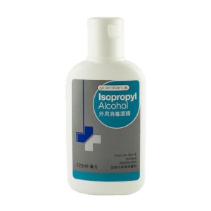

So, now I'm researching online and reading that 99% isopropyl alcohol will help with water damaged electronics. I went and bought some at CVS (they only had 91%) but whatever. This time, I took apart my phone using the ifixit breakdown. I took off the entire back panel and logic-board. I submerged each piece in the isopropyl alcohol for about 30 minutes. I gave each piece a nice gentle scrub with a toothbrush to make sure I was cleaning everything. Then, I dried with towel and I put each piece in a bag of rice over night for about 10 hours.
This morning just now, I put the phone back together. I knew this was my last shot after one night bag of rice, after one day distilled water and rice, and finally after one day 91% isopropyl alcohol and rice... there was nothing left to do.
I put the battery in expecting nothing. Then... suddenly... it vibrated! I looked at the screen and there was the logo! It was turning on!!! I was still not optimistic as I know water damaged phones can lose functionality... but I tested everything out and everything works! Air View, Air Gesture, speakers, calling, etc... everything works!
So in conclusion, I would say the isopropyl alcohol was the game changer here. That stuff really works. I've even seen YouTube videos where people submerge a turned on phone in the stuff and it still works because it does not conduct electricity at all. Pretty cool.

I bought some tools and I bought Isopropyl alcohol liquid.
Luckily I manage to tear down everything without damaging.
At first I only took the motherboard and dipped it in that liquid for about 24 hours. It didn't work.
So the next day, dipped the mainboard for one day.
Charging board which has corrosion was also dipped in the liquid for one day.
Brushed here and there.
Next day, assembled everything back.
Voila!!!!! It was bloody booting.
It worked!!!!!!!!

Okay so I bought one of those rubber pouches that are supposed to protect your phone at the water park. Well, vacationed for a week, got home and the screen went black. I took it to a servicer and when he took the back off the battery indicator was fire engine red. There was also evidence of dried water on various areas of the panel board and mother board. I went to CVS and got the alcohol. I disassembled my phone into 4 parts back cover, back panel, motherboard and screen component. I sat everything in the alcohol for 30 minutes or so then took all of it out and into the rice bed it went. I am waiting, waiting, waiting. I am so anxious to see what's gonna happen. 11:30pm will be 12 hours. I think I will go to bed at 10 so I will wait until morning and give it additional time.

Just a quick question. Is isopropyl alcohol the same as the hand sanitizer that we use daily or is it the rubbing alcohol or something else
