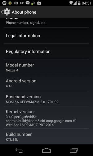

Updated June 11th, 2014 for 4.4.3

Finally proceeded with the update, with the expected results: bricked device. After reboot and installing through TWRP, booting up showed me only a blank screen. Steps to fix it, mostly as described here from 4.2 to 4.3:
http://forums.androidcentral.com/go...fail-even-after-hard-reset-3.html#post2964040
Install latest TWRP
Download official 4.4.3 image https://developers.google.com/android/nexus/images#occamktu84l
Enter TWRP, wipe Dalvik cache, fix permissions. After this you get at least the loading animation, but stuck there forever.
Fastboot flash bootloader bootloader-mako-makoz30d.img
Fastboot reboot-bootloader
Fastboot flash radio radio-mako-m9615a-cefwmazm-2.0.1701.02.img
Unpack occam-ktu84l
Fastboot flash boot boot.img
Fastboot flash system system.img
Enter TWRP, wipe dalvik cache, fix permissions, reboot. Here it will ask if you want to install SuperSU, say yes (i had this in the root folder.. from the previous time, I guess TWRP detected it.. idk, you need to re-root the device after this major OS update).
After this, I get the new loading animation, then it asks me for encryption password (very good sign), then I get Update Android.. takes a couple minutes, then I'm back in the OS to enter my PIN and everything is there, all my data is there, all installed apps with their data are all there, home screen as before with all the shortcuts etc.. as if the update never failed.
