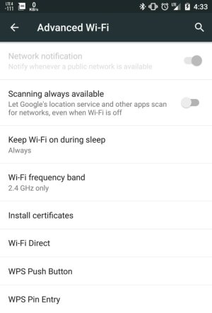

Go to settings, wifi, advanced, and ensure you have keep wifi on during sleep set to always.
You're right it's there for battery reasons but it is a function that can be changed. If it is doing it on all those phones I would say that the wifi you're on is having an issue more than the phone since it is 4 different ones. On all my phones I always have it set to keep the wifi enabled during sleep and never run into issues where it disconnects.

they cant change the settings in your phone remotely. if you set it to be on then it will stay on. if this happens on all your phones then its your wifi thats not working properly...
My T-Mobile G4 has the option to keep WiFi on when screen is off and it has always been enabled. Hopefully, that's the equivalent of while asleep.
You mean like this?
It's been on from day one.

Sorry, but I can't make out the screen shot.
It just shows that the "Keep wifi on while sleeping" flag is set to yes
Could we get a clear picture. I've never heard of that option from anyone I've asked or know, nor have I've seen it on any phone I've had.
