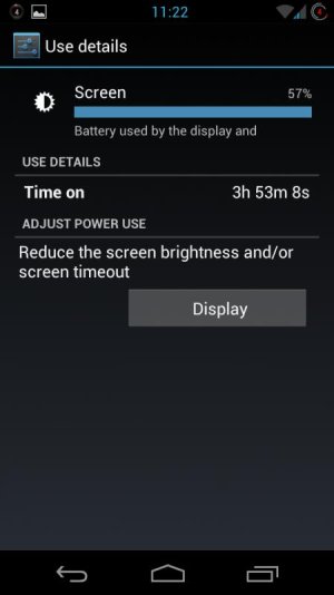

With 11 hours of use and almost 4 hours of screen time, who wants to leave Liquid? :D
