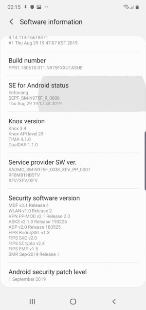

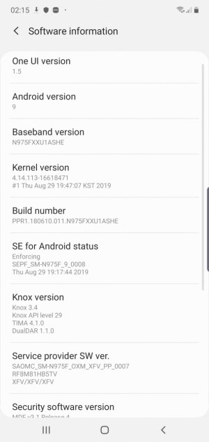

This is strange , when you open your phone and go to settings scroll to the bottom about phone then tap software info take a screenshot of that for me

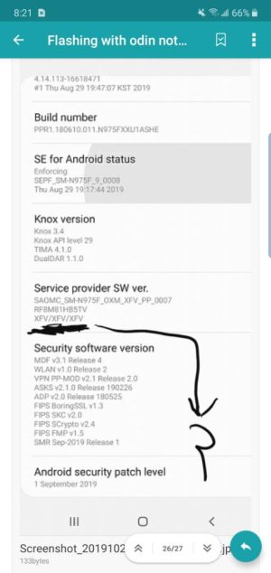

It successfully download the firmware
But 3 codes XFV where I highlighted the 2 on the left should of changed and last one stay XFV 20191020_202301.jpeg
