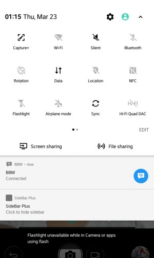

Do you mean like this? I just tried and knew it. Is it good or not? Or is it the default setting?

I'm thinking he means he's getting an error. That the camera is actually not in use. They have never come back to respond so we don't know.
Correct the camera is not in use and I keep on getting this error on my LG G5.
Have you tried it in safe mode to rule out a third party app? If it still does it in safe mode I would try doing a factory reset after backing up your data. I would start with a clean install....if that works then I would only add necessary apps to avoid adding any third party apps that may be causing the issue. If that doesn't work, I would assume your device might need repair.
Thanks. Actually it does work for 5 seconds, than it turns off with a error message: "flashlight turned off due to flash- related app in use"
