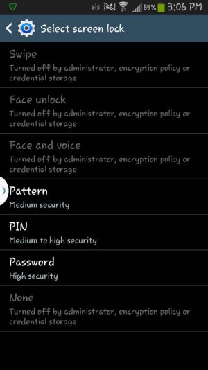

So I just installed the certificate and everything is working perfectly as far as foxfi goes but I have a question about the lockscreen changes that were made during the certificate installation. They made me activate a screen lock by choosing a pattern,pin or password , I was not using a screen lock before this and now I'd like to change it back but on the screen lock settings page certain selections are now grayed out with a note under them saying "turned off by administrator,encryption policy or credential storage" how do I make the grayed out selections available to me?
Here's a screenshot of what I'm trying to explain in the above post
