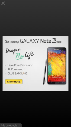

for last few weeks i have started getting full screen pop ads.
ads are random. not directed on specific products. each time they turn to be endorsing some other product.
i need not be working on any app. most of the time ads pop up when i m on home screen. i hold and long press to know the add source, but it says nothing (i did this after Air Push Detector advised me to do so.)
I ran Ad Network Detector and Avast anti virus. both came up with no results.
its getting annoying, although the ads do not pop up often . may be twice or thrice in a day or so. but i would love to have it detected and taken care off.
i have attached two image, when i press the left bottom option in first, all i get is tiny lill pop up in second image.
Thank you guys.

I found a solution. When the ads pop up. Hit your home button for few seconds to view resent apps if using 4.2 android or whatever technique to see recent apps.
You should see the ads along with recently used apps and the ads are generated by " network service" . go into settings-apps-all apps-scroll to network service and disable or deactivate. It will work. I had the same problem.

This worked for me. I have 2 different ad detectors installed, and neither of them found this app. Then when I got a random popup ad (some natural food chain), I hit my Open windows softkey (its the softkey to the left of my home button on my galaxy s6). This showed all recent apps, including the add....it was from Peel remote. weird thing for a remote app to do, but I force stopped it and disabled it. well see how it goes from here. It must be a system app since i cant uninstall it.

Had same problem on Galaxy s5. Opened recent apps after pop up and the ad showed up inside the Peel remote app. Blocked notifications from it and disabled so we'll see if I get more pop ups.
My Galaxy S8+ had small, medium and full-screen ads popping up everywhere at random times. I deleted all apps I felt were suspicious, but the ads continued. I installed and scanned using two top-rated anti-malware programs (Malwarebytes and Comodo). Both failed to find the problem. Comodo presented two false positives which encouraged me to uninstall two perfectly good apps. The ads kept coming--even popping up while running the malware scans!
Next, I tried ESET. Within two seconds of starting a scan, it found TrojanDropper.Agent.BXQ hiding in the NextRadio app. Afterwards, it let me remove the app and malware with a single click.
Note: The above was essentially copied from my user rating/comment for the ESET app. If this sounds too much like a commercial, feel free to delete it. But I stand by everything said here. There are many possible causes and multiple solutions for unwanted pop-up ads. I hope this info can help at least some of those affected by this annoying problem.
Thank you everyone - this has been frustrating! I tried ESET and Malwarebytes and both came back clean. I can't hold home button because it prompts me to 'set up google assistant'. I DID however just think to open Advanced Task Mgmr a third party app and found something called QuickMemo+ running. I uninstalled this now- it's interesting and sneaky how that seemingly innocuous tool name my eyes glanced right over when I have been reviewing ALL my apps. Highly recommend Advanced Task Manager and opening it when an Ad pops up. Now I WAIT to see if any more pop ups will happen - hoping this resolves it for good.
