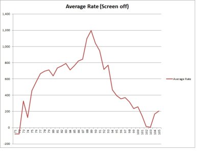

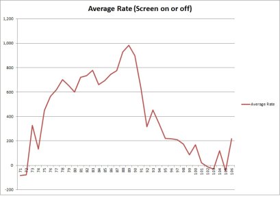

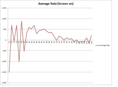

I pulled the data out of my battery monitor widget, and removed recordings where the phone was unplugged or on USB. I've also removed the readings when battery was at 100%. I have 3 charts - screen on or off, off only and on only. I think that on my phone at least the data shows that around 90 degrees is the drop off point (as someone else mentioned). Honestly, im not sure what to make of the peak being at 90 with lower values before and after. Any other thoughts?
I will have my wife put the monitor on her phone and see if I get a similar chart.
