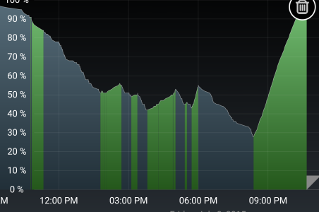

I have the exact same issue. Happens at home too. Sometimes it charges at 5% am hour and sometimes it discharges. See attached.
With my s5 it wouldn't charge at 1.8 ampa while using his but I'd get a good 1-1.5. With the g4 ampere shows 200 mah if I'm lucky, and sometimes it's -500.

Do you have a graph like that showing battery % and also showing battery temperature? GSam Battery Monitor can show a graph with that info.
I'd expect you'll find that the slow charging happens when the battery is warm, and if the drain on the battery is high enough, you'd be more likely to actually discharge as the temperature increases further.

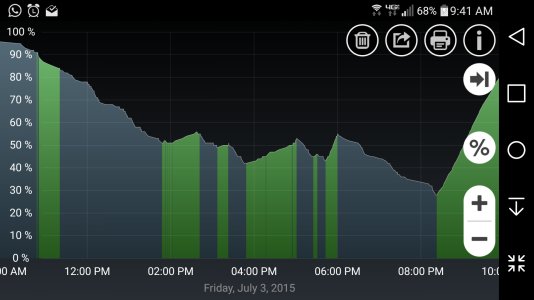

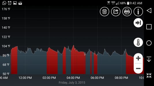

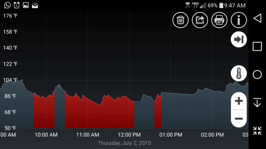

Doesn't see particularly high, but it does look to be temperature related

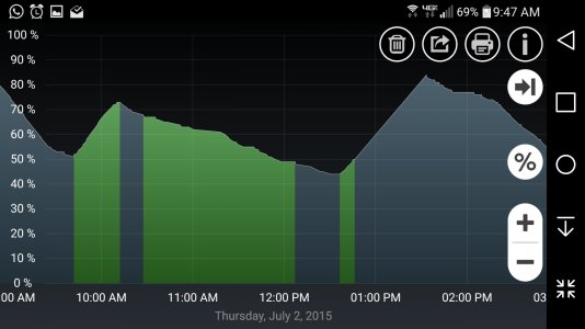

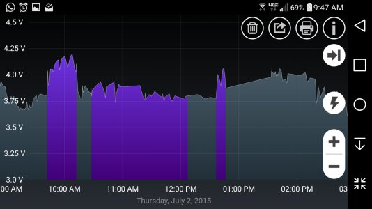

Then again this series tells a different story. Although may be the voltage is responsible? Maybe not a good charger connection here?
The charging while Gray was cuz phone was off

I'm pretty sure the voltage shown is the battery's voltage, not the voltage received from the charger. In part because it's always showing a voltage, and the range makes sense for the battery. Regardless, it does seem to help a bit if you use a good charger, and a good, thick cable. Cheap cables typically have thinner wires, which have more voltage loss through them, reducing the power available to the phone, especially as the current increases.
Battery Monitor Widget does a nice job of capturing this info, it has a History tab that shows you a table of measured values, over time. So rather than trying to look at the slope of the battery line as it goes up/down, and matching it up to other graphs, you can see the actual current going into/out of the battery. It also shows the battery %, as well as the battery's temperature, in that same table. So at a glance, you can start to pick up trends, like the charge current is reduced when the battery reaches a certain temperature. Or that with charger X, you get a certain charge current, and charger Y gives something else. You can also see that it in 40 minutes, you gained 20% charge, or whatever.

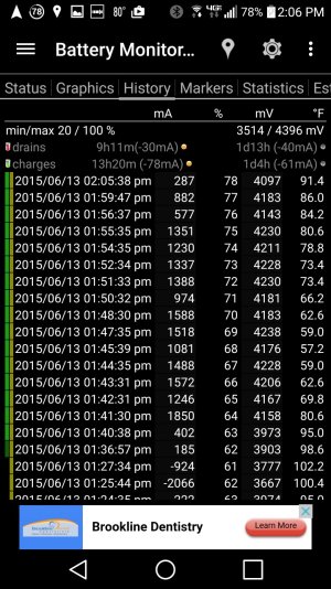

I observed that the charge current would reduce to about 300mA once my battery reached a temperature of about 90F.

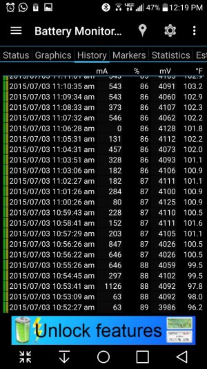

So i have battery monitor widget. Screenshot attached. Is there any way to export the history so I can work it in a spreadsheet.

Yes. Tap the gear icon, then go to Battery, then "Export battery history".
If you turn the screen off, the yellow bars on the left will go away. So you can see how quickly it charges with the screen on, vs off. I make sure to test long enough that any "partial" monitoring intervals are ignored. That is, turn the screen off, and let it record maybe 4 intervals. Turn the screen on again, and ignore the first and last that show the screen was off, because it may have still been on for part of those intervals.
