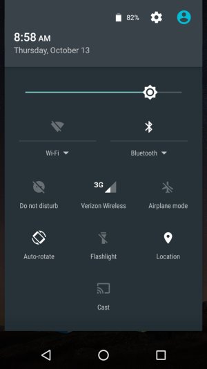

I turned off my Note 7 since it is officially done and needed a phone to use while I await my Pixel XL. I had a spare Motorola G4 and I popped in my SIM from my Note 7 and it it worked right away...however, when outside WiFi and on cellular data, it only shows 3G...I'm able to stream audio fine...surfing is a tad slower but it works for sure as a temporary solution.
Just wondering if there is any way to get the full 4G with this on Verizon?

Good tips...I have switched it to LTE/CDMA and waited for a while and still just 3G:
I am also in the APN settings and it is listed as VZWINTERNET. No reason to change that, right?
