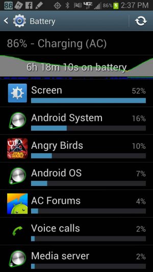

Hmmm, I realty don't understand what all the stats mean (sorry) but here is a shot of mine from settings>battery..... 9300 mah, wow, I didn't know there was such a thing.....I thought the 3100 (I think it is) was the biggest for our phone????

This is what I got out of about half of my battery but I've been on Wi-Fi since after work Friday... I typically subscribe to the 50% depth of discharge method and using that I only have to plug in once in a 24 hour period most times! That held true even when I was using a Galaxy S3 as well...

Yeh that's not bad at all. Over a day with about 7 hours screen time. Not bad with a stock battery

That's what I'd likely get if I used it until it went to zero I believe! It's always MUCH better on the weekend than during the work day due to signal issues in my building!

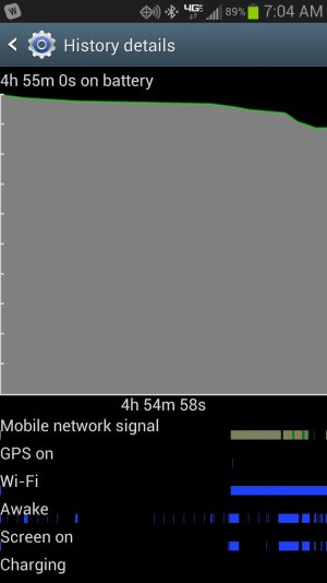

Here's my snapshot from this morning...I use airplane mode over night but notice all the instances of my phone waking up...
Sent from my Galaxy Note II using Tapatalk
