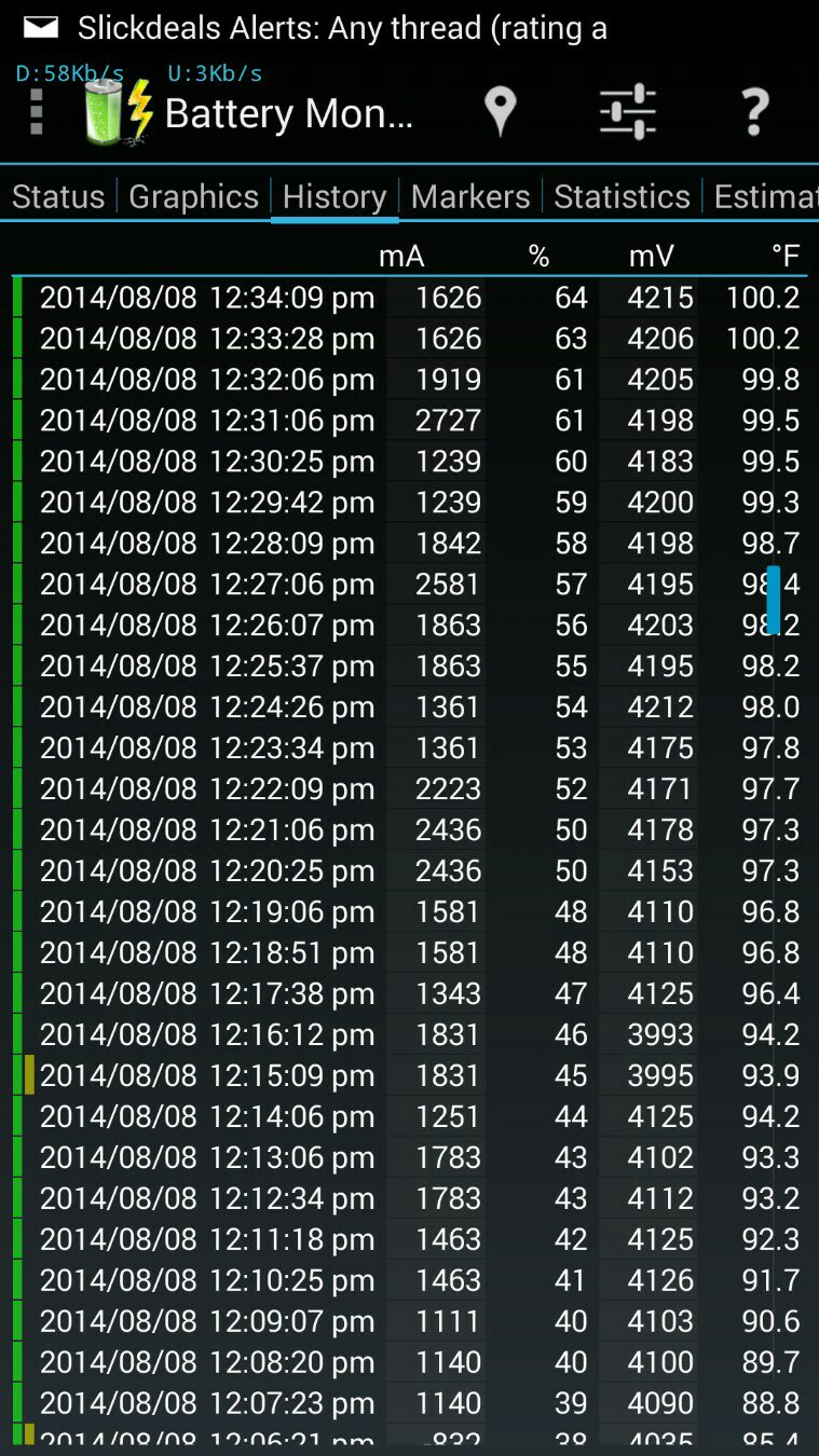

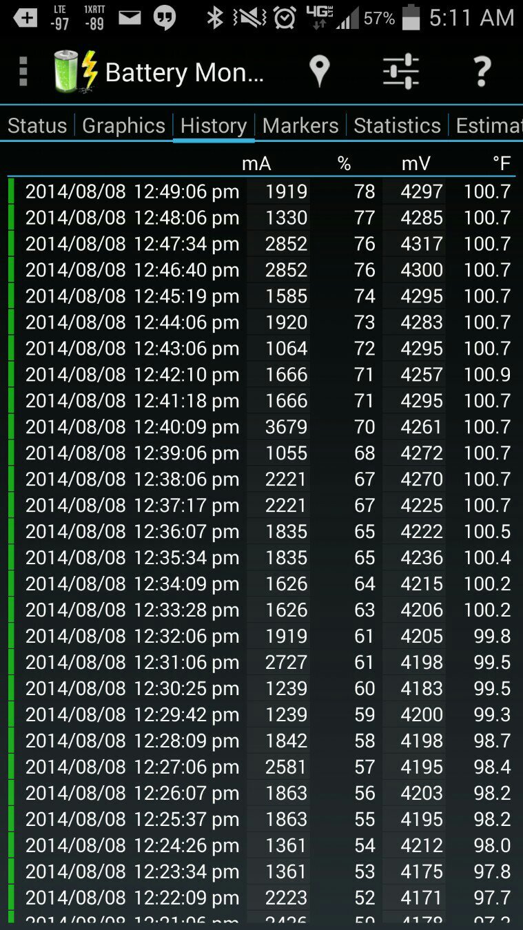

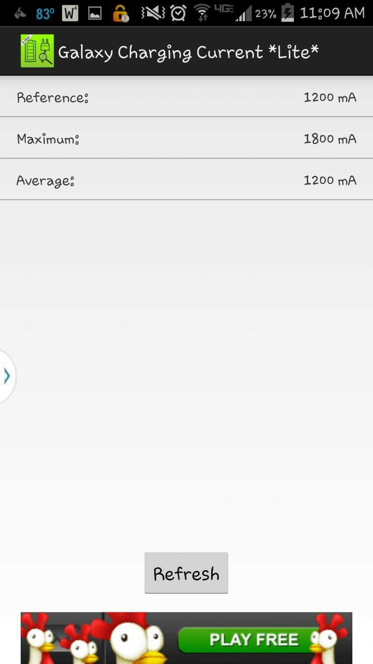

Wow. Never have I seen a thread get so technical about max charging amps and etc.
OEM Note 3 charger
Old OEM LG Charger using Note 3 white charging cable.
Guess there's a big difference in these chargers.
from "Ms Note 3"
Samsung supplies a 2 Amp output charger. So using a charger with an output of 2.0 to 2.4 amps would seem to be suitable. While I have charged my Note 3 using a 1 amp charger it definitely took longer than on the OEM 2 amp charger. A 700 mAmp charger couldn't even hold Note 3 battery level when the phone was on and idle.
If you are running an app and have the screen on to read it then you can't be seeing the max charge capacity as you are using battery to power those items.
Yeah, that's why I only use LG Charger when I need to borrow Samsung charger to power my tablet.
