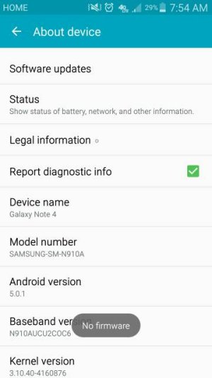

When I updated and it failed and tried the update again it wont let me check at it again it just shows no firmware at the bottom of the screen. Has this happen to anyone else and how can I fix it.
Posted via my note4
