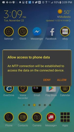

Problems with "Allow Access to Phone Data" Deny Allow. Keeps popping up and I press Allow but my phone via USB show in OS but the window closes and I keep getting the Deny Allow and then the window closes again, over and over. I can't drag music to my music folder nor add apps via Wondershare Mobilego. I do not have have this problem at all with my Samsung Galaxy Tab S, the computer recognizes it and I get one "Deny Allow" message. Only the Note 5 has this problem.

No. Happens with both MobileGo and Windows Explorer "This PC." As I edited above, only happens with the Note 5 and not at all with my Galaxy Tab S. I am in Windows Explorer and the Tab S shows up with MTA privileges and one prompt for "Deny Allow" from the Developer Options which I tap "Allow" with no further prompt. It's the Note 5. Each time I touch "Allow" for the Note 5 the Windows Explorer window closes and I have to open it again and tap "Allow." Over and over. I use MobileGo primarily to install and uninstall apps.

Shows up on on the Note5. I don't know exactly where the "Deny Allow" comes from, it just shows up on my phone screen. It just keeps popping up, I click Allow, and the Explorer Window closes. Same with MobileGo, wants me to attach the USB again over and over to the phone. I don't know what the heck is going on. Screenshot from phone attached.

Do you have any 3rd party security apps installed? If so, try turning them off or uninstalling them. Or you could boot into Safe Mode and see if the problem still happens: https://support.t-mobile.com/docs/DOC-27639
Well, I disabled three virus/malware apps and everything appears normal now. However, when I re-enabled the virus/malware apps, the problems did not appear. So don't know about that. I have Bitdefender, Malwarebytes, and Eset Mobile Security. I'll try again tomorrow with those apps enabled, after a restart, which I did anyway after I turned them off, but everything worked. So it's got to be one of those...and I also have CM Security as well.

Thanks for the info. It appears that the culprit was a third part and respected Windows start menu app I paid for: SmartMenu X.

Quite accidentally when I tried to access the phone and had the problems, my PC went to the green Start screen and Startmenu X was closed and the Windows 8.1 Start menu was in place, then I had no problems accessing files on the phone via Explorer or MobileGo. When I restarted StartMenu, the problems resurfaced. Have no reason why. I'm going to have to exit StartMenu when I want to connect the Note 5. However, doesn't seem to affect the Galaxy Tab S in that way...
