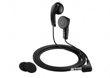

I recently Purchased a Sennheiser MX 170 EarPhone.
When i normally connect this to my S2, the music still plays through the speaker of the phone.
But when i tilt it & put a pressure on it then it plays through the headPhone
& as soon as i remove the pressure it again plays through the speaker.

The Sennheiser headphone has an "L Shaped jack" & a small Shroud.

'coz this samsung one has 3 rings whereas sennheiser mx 170 has 2 rings :
