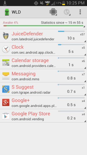

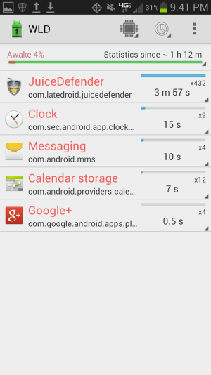

From your Wakelock Detector screenshot, it looks like Juice Defender is keeping your phone awake. It's probably hurting the battery more than helping it.
I turned it off, it being JuiceDefender, and the battery is still draining. Now at 15% since time of the picture. 2% in 8 minutes on airplane.
Did you uninstall the app? Try charging it all the way and rebooting. If it was JD, it will go back to normal

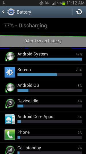

I've had it unplugged for an hour and 15 minutes, 77% battery.

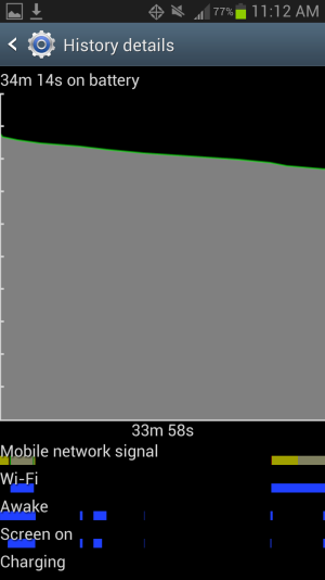

The screenshots show that you had it unplugged for 34 minutes.
And that it was at about 87% charge when you started.
Did you have it in Airplane mode for most of the 34 minutes? You have a really lousy cellular signal for the remaining time - you might want to try GSam Battery Monitor Pro: http://market.android.com/details?id=com.gsamlabs.bbm.pro (there's also a free version) to better quantify your cellular signal.

And just as a follow-up to your original posts and replies - I'm in complete agreement with Golfdriver97 about marginal cellular signal - that can kill a fully charged battery in a few hours: it used to happen to me all the time when I worked in a shielded lab and I finally had to put the phone in Airplane mode whenever I went in to work.
Also, if you really want proper analysis of battery life (well, the best we can provide in the forums anyway) you need to:
- start with the phone fully charged - IMPORTANT
- do not introduce any intermediate charge cycles
- let the battery run down to 20% or less
- include all three screenshots (you've been leaving out the Screen Use details) [also include the Radio Detail screenshot if you're using that app]
