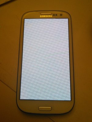

Last night, after a nap, my phone's Galaxy S3 international (SO is 4.4.2, un-rootted) screen was lit and showing only what I can describe as static.
The phone is not respoding. Doesn't reboot, does not show the Samsung logo or anything. Just the lit screen with static.
I plugged into the computer, and it recognizes and installs the drivers, though it does not connect to the Kies software.
I left it without the battery overnight and still the same situation.
Can anyone help?
thanks in advance
TO anyone that might help
Can anyone help?
thanks in advance
take out the battery for 10 minutes and put it back
Go to recovery and clear cache and data
if that doesn't works reflash your phone using odin
When you insert the battery does the 'static' screen immediately come on?
If not, at what point after you press the Power button do you see that screen? Does it make any of the normal boot up sounds?
Sure sounds like a problem with the display hardware: possibly the screen; possibly the mainboard - hard to say without further experimentation.
Sent from my rooted, debloated, deodexed Sinclair ZX-80 running CM -0.001 using Tapatalk
Thanks for replying.
It does not make the booting sound. The screen comes on after about 2 seconds of pressing power.
I have tried to hardware reset (up volume + home + power) but just shows the static screen, turns on and then black, and static again, and so forth.
