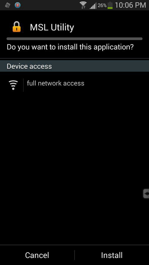

Get your msl code for sure with the attached apk
I've attached the SPCUtility.apk and it will give you your MSL/SPC without a doubt. I've used it 100 times and it's always worked but of course you must have root. Install it, click read MSL/SPC and within a 1/2 second you will have it. Yeah you right.

Ive downloaded the SPCUtility but I cannot open it. Where and how do I open it?
If you navigate to wherever you downloaded it (on my phone it downloaded to /storage/emulated/0/Download) and select it, you should receive a prompt to install it
Once you've installed it you can open it and follow the instructions

Settings / More / Security, check "Unknown sources." After installing the app, I'd suggest going back and unchecking that option.
