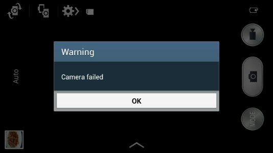

So I went to use my camera today and a black screen popped up and then seconds after a warning box appeared and said camera failed! I did a soft boot and factory reset and nothing will fix it! I'm over my 15 day trial period so I can't take it back. Anyone else experience this or have possible fixes?!?!

Re: Galaxy s4 camera failed! Please help!
I did a search and found quite a few people dealing with this. (I don't know if I'm allowed to post links to other forums, so I won't).
Some are sure the issue is something called the Camera Module, and are buying replacements for about $20 on ebay. Others have said they power their phone down and leaving it off for 15 minutes, restarting, and are having success with the camera working again. Others are saying they are rebooting 5x and having success that way.
Do a web search "galaxy s4 camera failed" and you'll see the conversations I'm speaking of. Good luck.

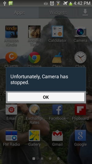

I'm having similar troubles, with some exceptions. The camera doesn't work as an independent app, but when I'm in FB I can use it to add a photo to my timeline, but it won't work in a PM. I can use it on another app called VarageSale to take photos, but in text messages it doesn't work.
I have restarted, soft reset, cleared camera cache and date, removed the SD card. Occasionally one of these will work, but then I attempt to turn 'selfie' or frame in frame on, and 'camera fail' again. SO FRUSTRATING

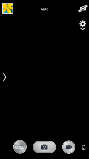

screenshot_0405164236.pngI have tried everything minus replaceing the camera module. I dont really feel like doing that yet unless there is some solution out there. This is cra* this is a brand new phone. Only had for 2 weeks and the camera went out last week. Help!
