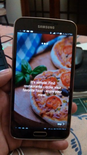

i bought this set g900-h in august.
it was going fine but now it have started acting strange. the screen starts sliding up. i mean the date on the uper right corner starts to show on lover right corner when the cell is idle (with screen on) e.g. reading emails etc.
can some one help me out. as i reside in pakistan and i dont think there are any samsung official people around.
