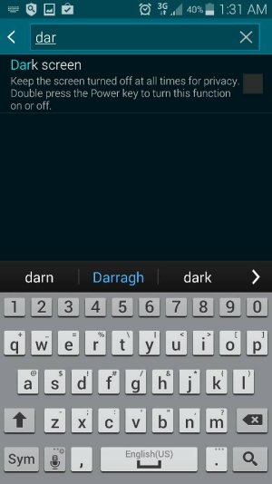

Actually, I just figured out what it really was the first time. The second time was definitely what I said before. But it was just a coincidence. Check out this pic!

dark screen, where is that option on the phone???

I intentionally applied it and there's sounds as well. So must be a glitch enabling the screen function of it. The shortcut is 3 power button presses to turn on or off. Try that even if it is not enabled.
