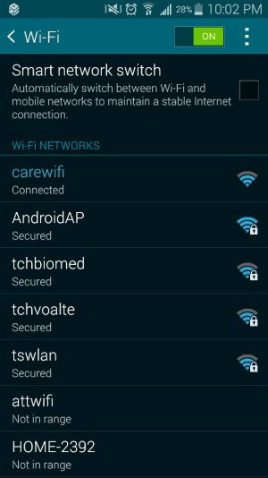

Once you go to wifi, smart switch will be at the top.
