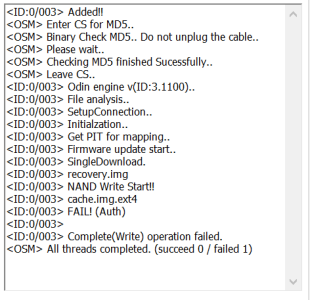

Hello,
I tried to root my Galaxy J3 SM320F. But I got the same like above.
<ID:0/005> Complete(Write) operation failed.
<OSM> All threads completed. (succeed 0 / failed 1)
But now, I can't start my phone. It says:
"Firmware upgrade encountered an issue. Please select recovery mode in Kies & try again."
But Kies doesn't connect to my phone.
Who can help me?
best regards Christoph
Hello,
Who can help me?
Hello and welcome to Android Central Toeffa
Each model of phone has different rooting methods and idiosyncrasies and what is true for the Galaxy S5 models will not be so for the various J3 models. You would probably do better posting, here.
