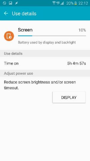

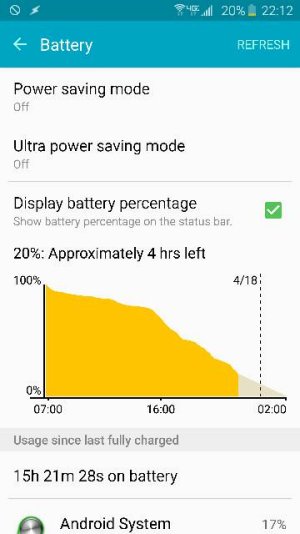

I have routinely gotten 5 to 6 hours sot with my VZ s6. The new update rocks! Over 5 today so far with 20% left.
