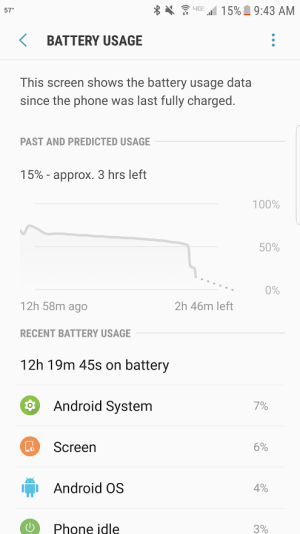

Hi all,
Over the last week and a half or so, my S7 Edge has been having a pretty peculiar battery drain issue. I don't know if it's an update related issue or not, but once the battery shows below (from when I've noticed it) around 50%, it will just instantly drain all the way to 0% in a matter of literally a minute or two. And the battery usage doesn't show any app as being a potential culprit.
Any thoughts on what to try? Did my battery just suddenly get toast? The battery life is great for that first 50%, BTW.
What makes it even worse is that it continues to drop to 0% even if I'm able to catch it at 15% or so and plug it in. Once it hits 0%, it charges and continues working as normal.

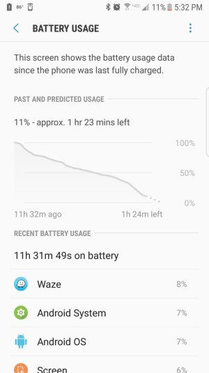

Below are the before and afters.
