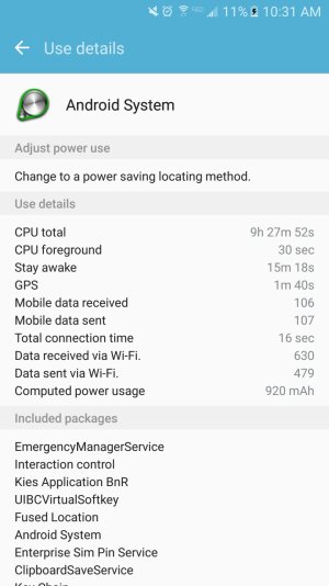

I've only had this s7 a few months, and in the beginning I as really impressed with the battery life. I could go to bed with it on 60% (without having it plugged in) and wake up with 50-55%
Recently, within the last 2 weeks, this has changed. My battery drains a lot faster now, and it's especially noticeable while idle overnight. Last night i went to bed at 12:am with it on more than 60% and woke up around 9:45 am with it on 15%. now its 10:09am and its on 7%!! what is going on??
Android System is at 40%...that's too high. That means something is running crazy and it's not necessary Android, it may be an app. Same happened to me where I would get 14-16 hours on one charge and overnight battery life dropped to 10-11 hours. Can't figure out why, no new apps installed... Good luck and if you find out what's the issue, please post it here so we may know.

Yeah 40% is rediculous, and now its at 42%. Heres another screenshot for those it might help, but I am clueless.
