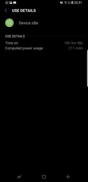

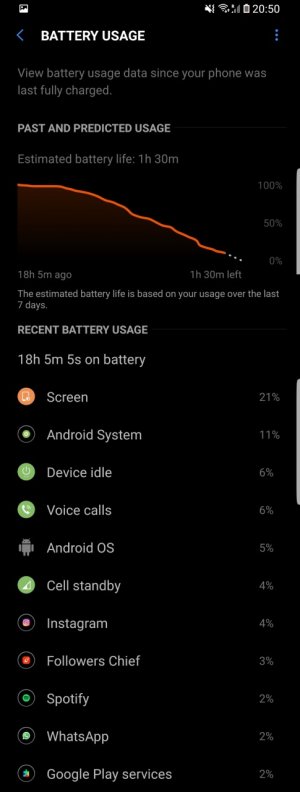

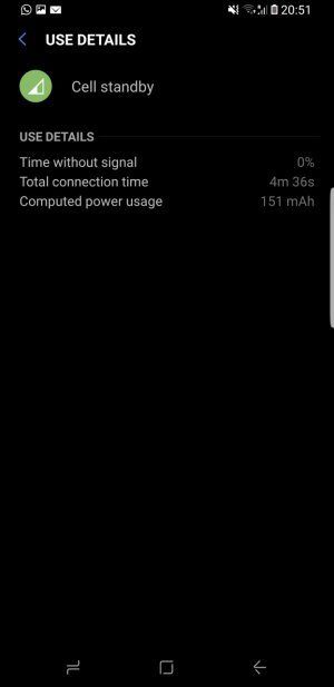

Ok, here is something interesting. I observed that the last three screenshot posted from peppythetruth, Anthony Mclean all have an SOT of 7 hours and 5 minutes. To achieve this SOT, the battery consumption is different for the three of them. One of them used 1200mah, another one used 1400mah and a last one used 1800mah. I assume this difference is due to different screen settings such as brightness or resolution.

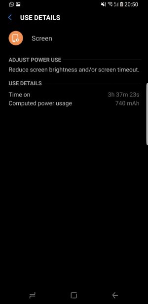

So I decided to go check out my own battery consumption for the screen. At 10% battery, I used 740mah of my battery for 3h37 SOT. If you do the maths, its not excessive. Alll you need to do is double is to see that with 1400mah i would have gotten 7hrs SOT just like everyone else. My problem is that i did not have those extra Mah to use because they were wasted somewhere else.
So my goal is to know where the rest of my 3500mah battery went ! Why do you three get to spend 1400 mah of your battery on the screen, and I only get half of that !

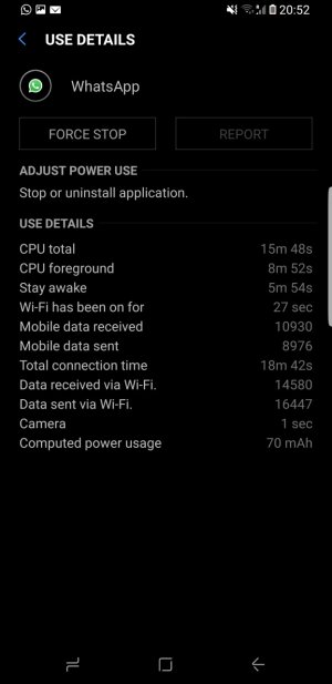

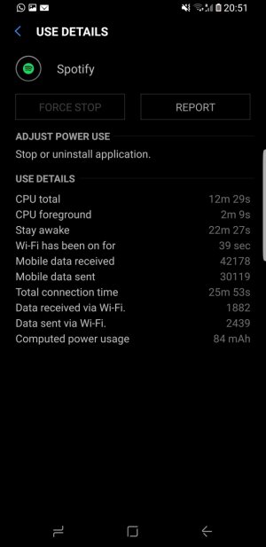

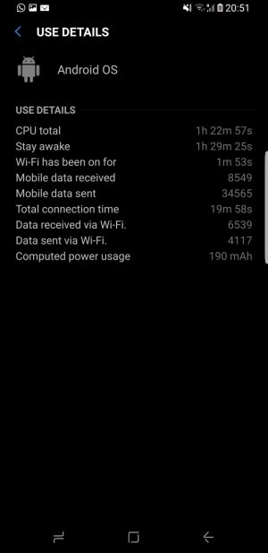

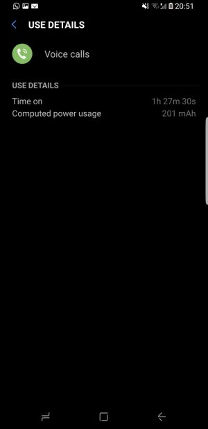

I took details screenshot of all the tabs in the battery section, and I am hoping that one of you will be able to compare, and maybe spot a diffenrence, so I can have a better indication as to what I am doing wrong.....
Here they are. Anything abnormal?

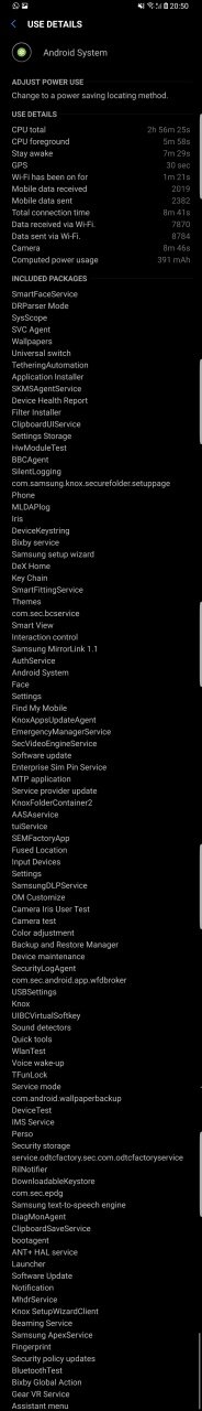

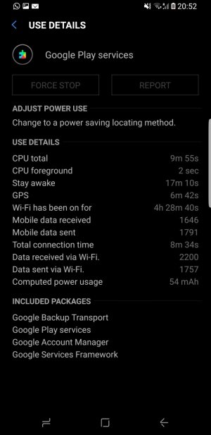

I have a problem with android os keeping my phone awake longer than the cpu time. Is this normal and if not how can I fix it? Here are the screenshots @70%

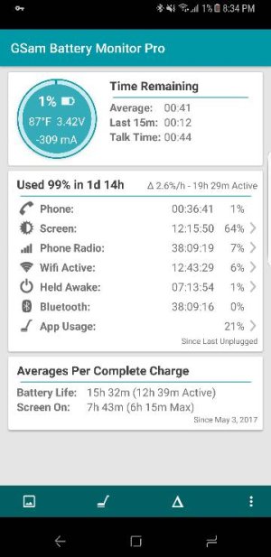

In practice that is not entirely true. I have poor signal 1-2 bars most of the time. Everyone tried to convince me that this was the reason why I get 4 hours of SOT only on my s8+.... So i did that exact test for one full day. I toggled airplane mode for the entire day and used the phone on wifi only. As a result I achieved 4h45 mins instead of 4 hours. Sure its an improvement, but only an extra 45 minutes for being on airplane mode all day?
According to your previous results, you probably would have gotten 3 days of SOT if you were on airplane more !
So no, signal is not what is killing our battery, but feel free to try if you want to...

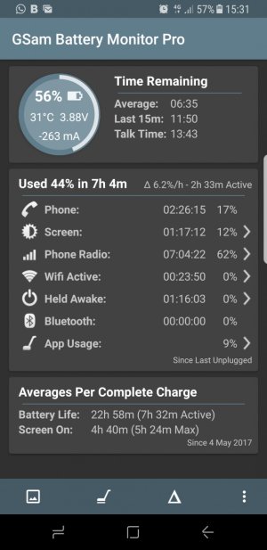

Check this. I had unplugged the device around 8.30 am and after 7 hours I find 'Phone Radio' responsible for 62% of the drain. Been at my office the whole time and signal is pretty decent as you can see. The total battery drained is 1300mAH (44% of the 3000mAH S8) and out of which 800mAH has been drained by Phone Radio!! This is roughly 2mAH/min and the rate of drain is similar to that of the Screen (160mAH over 73 mins). Guys who are topping 6+hrs SOT are either completely on wifi or they have 10bars of LTE signal!!!
Any thoughts (and help) on this mighty mAH killer?! Screenshot_20170509-153128.jpg
Check this. I had unplugged the device around 8.30 am and after 7 hours I find 'Phone Radio' responsible for 62% of the drain. Been at my office the whole time and signal is pretty decent as you can see. The total battery drained is 1300mAH (44% of the 3000mAH S8) and out of which 800mAH has been drained by Phone Radio!! This is roughly 2mAH/min and works out to be similar to the drain caused by SOT (160mAH over 73 mins). Guys who are topping 6+hrs SOT are either completely on wifi or they have 10bars of LTE signal!!!
Any thoughts (and help) on this mighty mAH killer?! View attachment 259615
6.2% battery drained per hour will mean 16 hrs of endurance. 44% battery drained in 2 1/2 hours of active usage will mean 7 hrs of usage. This is basically my iPhone 7 rebranded as Samsung S8!

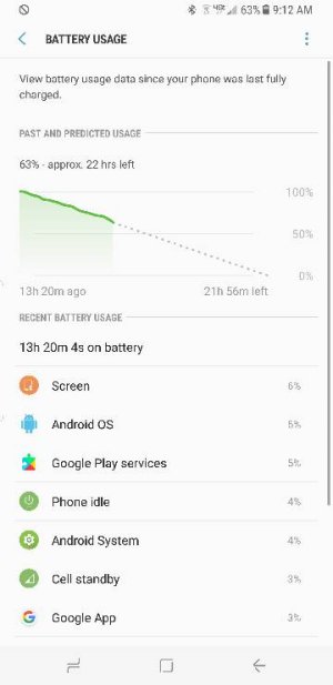

I am getting great battery life on my S8+ on T-Mobile
When I work from home on WiFi all day I can get almost 8 hours SOT
When I go to the office where there is horrible cell reception I get 6 hours SOT
I have my display resolution set to HD+. I have the display brightness slider at just under 50%. Which is plenty bright enough for me. I can adjust it if I am outdoors
I also have battery optimizations turn on with app monitoring. So when an app (like Facebook) consumes too much battery/power in the background.... it will be put to sleep
Love to use battery optimizations....they are a life saver
