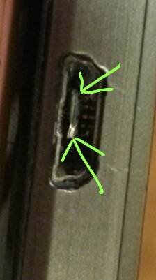

Sorry for the lack of technical terms, but here is what I found with my kids' tab 3 7.0. The USB port on the tablet is easily damaged and the pin can be bent to the point that when you plug a cable in, it feels secure, but the pin is bent and won't allow the device to charge. What I have to do occasionally is use a plastic tool to gently bend it back. Also inserting the cable at a slight angle with the bottom first seems to help prevent the problem.
