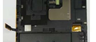

The only problem is when the tablet is turned off and charging, ordinarily you would see the battery indicator when you press the home button, this has been replaced by a blank screen with vertical lines.
I think the LCD cable might be loose, try to disconnect and reconnect the LCD cable, make sure the line on cable aligned with the one on main board.
Left side is touchscreen cable, right side is the LCD cable that you need to reconnect it ,
