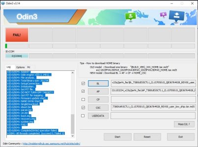

I can get device into Odin downloading and this is the odin log
<ID:0/008> Added!!
<OSM> Enter CS for MD5..
<OSM> Check MD5.. Do not unplug the cable..
<OSM> Please wait..
<OSM> Checking MD5 finished Sucessfully..
<OSM> Leave CS..
<OSM> Please wait..
<OSM> Leave CS..
<OSM> Please wait..
<OSM> Leave CS..
<ID:0/008> Odin engine v(ID:3.1401)..
<ID:0/008> File analysis..
<ID:0/008> Total Binary size: 3517 M
<ID:0/008> SetupConnection..
<ID:0/008> Initialzation..
<ID:0/008> Set PIT file..
<ID:0/008> DO NOT TURN OFF TARGET!!
<ID:0/008> Get PIT for mapping..
<ID:0/008> Firmware update start..
<ID:0/008> NAND Write Start!!
<ID:0/008> SingleDownload.
<ID:0/008> sboot.bin
<ID:0/008> Complete(Write) operation failed.
<OSM> All threads completed. (succeed 0 / failed 1)
Below are images, one from odin mode and the other when I try and go into recovery mode.

I tried again with Home, no luck and then tried again with CSC. It seemed to go farther this time but failed. Log below
<ID:0/004> Added!!
<OSM> Please wait..
<OSM> Leave CS..
<OSM> Please wait..
<OSM> Leave CS..
<OSM> Please wait..
<OSM> Leave CS..
<OSM> Please wait..
<OSM> Leave CS..
<ID:0/004> Odin engine v(ID:3.1401)..
<ID:0/004> File analysis..
<ID:0/004> skip file list for home binary
<ID:0/004> param.bin
<ID:0/004> userdata.img
<ID:0/004> Home Binary Download
<ID:0/004> Total Binary size: 2686 M
<ID:0/004> SetupConnection..
<ID:0/004> Initialzation..
<ID:0/004> Get PIT for mapping..
<ID:0/004>
<ID:0/004> There is no PIT partition.

Then post pictures, including any and all text that you see on the tablet screen itself. It should be throwing an error message in red, if Odin fails
